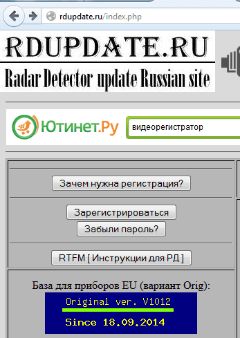

This is free. Press second button:
and on next page enter your preferable login, password, e-mail (need for confirm of activation) and captcha from picture, then press button at bottom.
If I do the update on rdupdate.ru following registration, everything would be fine?
First time your device get russian alternative data and russian voice set automatically. But this is one only way for tell update service about new device.
Next step - admin of service manually change voice version setting for device which have concrete serial number. In future you can change before update procedure version of data to "Orig" (official data) or "Alt", if you want to check device job without any GPS messages. Or for update on border of Russia if you need to have that trip... :)

1. Register on rdupdate.ru
2. update firmware one time here. During this update serial number of your device will be catched and registered in the system.
3. ask @Passerby to change voice version setting to English for your device and after this is done update firmware one more time

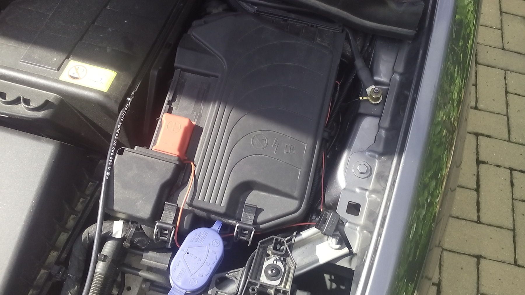

Hello everyone, today I installed the game.
I had to mount it horizontally, because vertically there is no space
It all seems ok. Voice in English (breaking balls every time I turn the car) but ok.
Satellites ok. W flashes properly. Immediately in the parking lot of the house tells me K band, there are no automatic gates, so I thought that the distance sensor that comes standard with mercedes pointing the wall or vehicle there in front of me. I did 2 km test. and it marks the speed correctly, he also signaled me to a point where normally the police put a mobile speed camera. One thing I do not understand it shows me 1 hour more than the real one in Italy. Tomorrow I do more testing.
Thanks again for the help.

Hold Mode to enter settings. Click Mode multiple times to paramerer #6 - time zone. Use up/down to choose +2. For LV I have +3 (we have 1 hour difference).
I recommend you also connect internal module thru custom button (switch), so you can turn it off fast because after connection is lost between internal and external module (in case of stop, because of powering based on motion sensor - RD210TX) after 3 minutes you will hear message like "radar detector is turned off". If police stops you and will hear this message game will be over ... :)

Js Hello, I followed your advice and now hidden better.
Thanks also for the suggestion of the hour.
