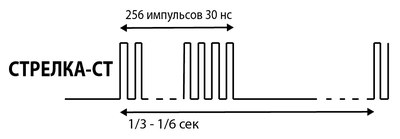

Что касается разницы между DMZ и радарной пушкой, то сигналы, поступающие, например, от STRELKA-ST и KRIS-P, выглядят так, что их было бы очень легко идентифицировать.
Крис-П - да, легко. Импульсы Стрелка-СТ 30нс (не мс!) и используется только в России - зачем Jon тратить деньги и время инженеров на рынок, где не будет продаж?
As for telling the difference between a DMZ and a radar gun, the signals coming from STRELKA-ST and KRIS-P, for example, look like they'd be very easy to identify.
Kris-P - yes, easy. Strelka-ST is 30ns (not ms!) and is used only in Russia - for what purpose Jon will spend money and

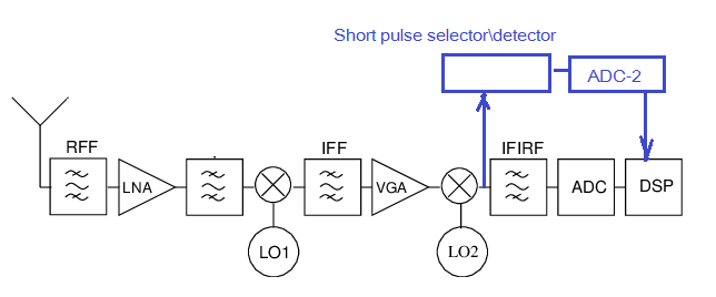

This is nanoseconds pulse. With duty cycle like 1\2, length of one packet is 15.36 microseconds.
Second intermediate frequency part of standard receiver can't pass this short pulse to demodulator due to limited bandwidth.
Cheap & useful solution is select this pulses after second mixer immediately in separate stream.

Kris-P - yes, easy. Strelka-ST is 30ns (not ms!) and is used only in Russia - for what purpose Jon will spend money and engineers time on a market with no sales?
30 ns is indeed extremely fast. Is that really how fast it turns on/off? We have 67ms POP that isn't legal to be used here in the US due to accuracy issues from turning on/off too quickly and that's more than 2 million times slower...
